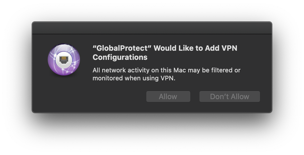

ktanaka
Issue 1: I am running into an issue with 5.1.4 where after it installs it prompts the user to allow it in SysPref>Security despite us deploying a kext/sysext profile a couple versions ago.
Issue 2: On a company configured device: If the user never allows the app it still functions. But after allowing, the user receives a prompt to allow GlobalProtect to add a VPN Configuration. This prompt pops up EVERY time it connects to VPN whether the user chose to Allow/Don't Allow on the previous connection. Company devices are set up with the old CIS benchmarks from High Sierra. Anyone know of a setting in CIS benchmarks that could be causing this? (Our InfoSys team hasn't given us an updated policy for Catalina CIS Benchmarks.)
On a personal device: after allowing the configuration it saves and uses it to connect on future connections.

mas19
Hi. In Test, we have upgraded GlobalProtect from v5.0.4 to v5.1.4. This upgrade is being delivered from JAMF Pro and works as should. However, on the client side after the update, the following prompts appear:

@Gonzalez This put me and others into the right direction. Since being a newbie, we already had the Kernel Extensions created for previous versions of GlobalProtect. For the new version of 5.1.4, we enabled Systems Extensions due to going forward with Catalina requirements. On your payload for Application & Custom settings, curious to know your settings to see if it would be applicable. Thanks again sir!

@mas19 I'm seeing the same thing. I have two different PPPC profiles. One matches the previous (up to 5.1.4) binary identifier "com.paloaltonetworks.GlobalProtect" and one with the new (5.1.4 and newer) identifier "com.paloaltonetworks.GlobalProtect.client" allowing access to the user's Desktop / Documents / Downloads folder, and the prompts still pop up when upgrading from 5.0.x to 5.1.4 (or 5.1.5). It's not obeying the profile, as best I can tell. I have a ticket open with Palo Alto but no progress to report.
I'd like to request anyone else with similar issues please open a ticket with PA so we can get some traction on this collectively.

@mas19 I am having the same issue and opened a ticket with PAN - no really luck getting them to help though.
ablend
It appears the problem is the change in the bundle identifier for an existing application in Catalina. If GlobalProtect is installed with the 5.0.x and previous bundle identifier of "com.paloaltonetworks.GlobalProtect" then is updated to 5.1.x and the new bundle identifier is "com.paloaltonetworks.GlobalProtect.client", the user is prompted regardless of what PPPC profiles are in place. That same behavior does not exist in Mojave.
However, if you uninstall GP 5.0.x then install GP 5.1.x, it obeys the PPPC profile and the user doesn't see anything. So it looks like we might need to be raising tickets with Apple rather than Palo Alto. I understand the logic behind wanting the user to "acknowledge" when a bundle identifier changes for security, but there needs to be some kind of an exclusion for when that new ID matches MDM delivered PPPC profiles.

Here is the official response from Palo Alto engineering:
As per our engineering team there is no way to block the pop up from showing multiple times. This is an MAC OS related issue and GP cannot fix this. Following is an explaination provided by our engineering team.
If using the System keychain, there is no "Always Allow" button in pop-up dialog, the system API will trigger the pop-up every time when a new connection is establishing. Sometime System keychain is in "Locked" status for GP process, GP will call some system API to "Unlock" it to retrieve info. In this case, there will have one more pop-up. Basically it's system behavior and GP cannot control it.
