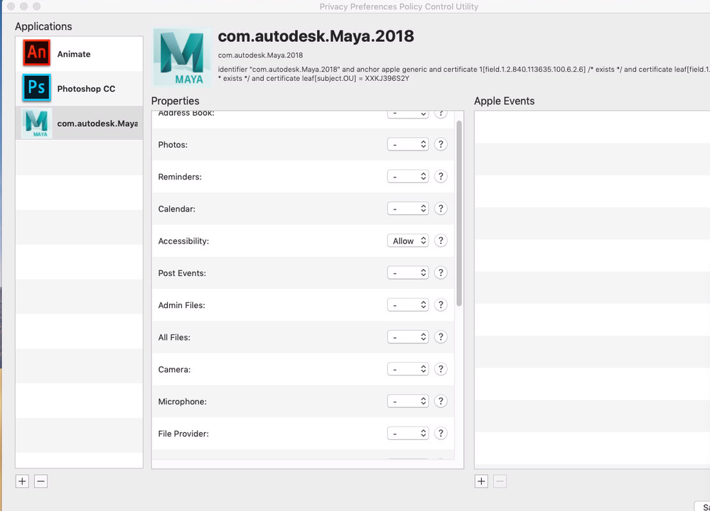

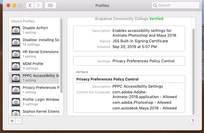

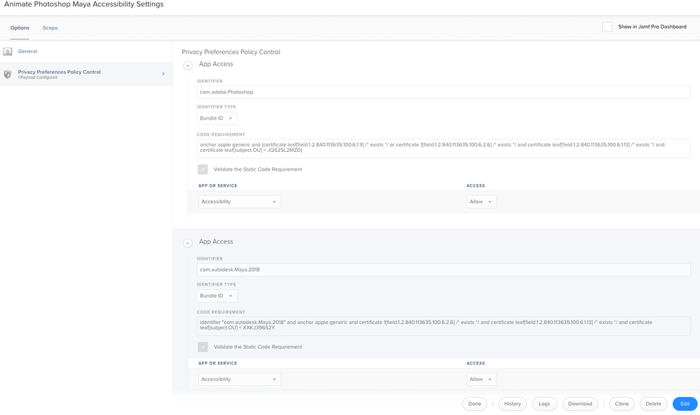

mhegge
I used https://github.com/jamf/PPPC-Utility/releases . to add Animate, Photoshop and Maya 2018. Unfortunately, the confguration profile did not change a thing.
What am I doing wrong?
JAMF Pro 10.12.0-t1555503901f673f4dcade14afaa8ec3d1981d71ae5

mhegge
This seemed like a very simple process. Apparently I am missing something.
mhegge
Was informed the changes will not show in the GUI. Which I find ridiculous.
