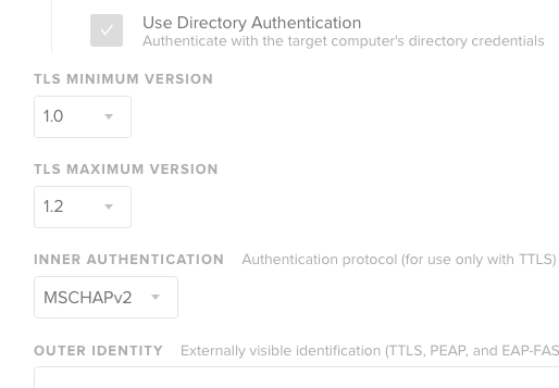

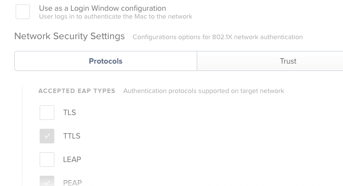

@LovelessinSEA so we configured the network payload for PEAP and TTLS, MSCHAPv2 with the relevant wifi settings and ticked use directory authentication. Then we uploaded the Root CA to the certificate payload and then added that to the trust section of the network payload. It worked straight away. The only niggle I have is getting the proxy settings correct - if you leave the WAN and rejoin without logging on from cold, smooth wall idex doesn't like it!!!!
