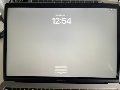

I’ve set up Jamf Connect with Google IdP following the documentation and tested it; everything seems to run fine. However, I've run into issues during PreStage Enrollment deployment in Jamf Pro. I can’t seem to launch Jamf Connect properly for local account creation to show the Google login screen. Right after the Setup Assistant, it only shows a black login screen with empty fields for user and password. According to troubleshooting, it might be due to the permissions in the package, but since I’m using the official Jamf Connect 2.42.0 package and distributing it through Cloud Distribution Point (Jamf Cloud), I don’t think there should be an issue.

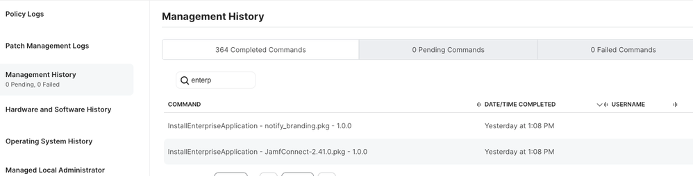

A_Collins
Check the management logs. Under history of management logs, you would see something like this if it is installed. Screenshot 2024-12-18 at 09.43.39.png
liska
Yeah, well the log shows the entry and it’s not failed, but I think the application still isn’t running or maybe it didn’t even install.
